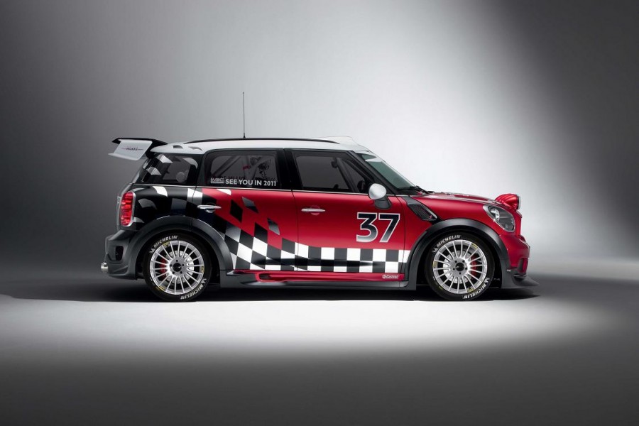

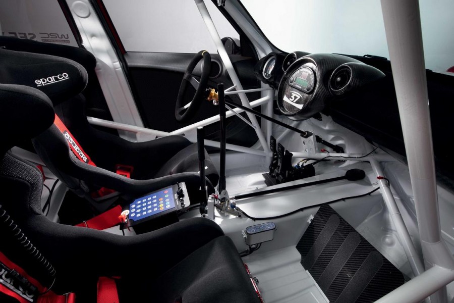

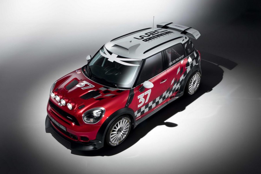

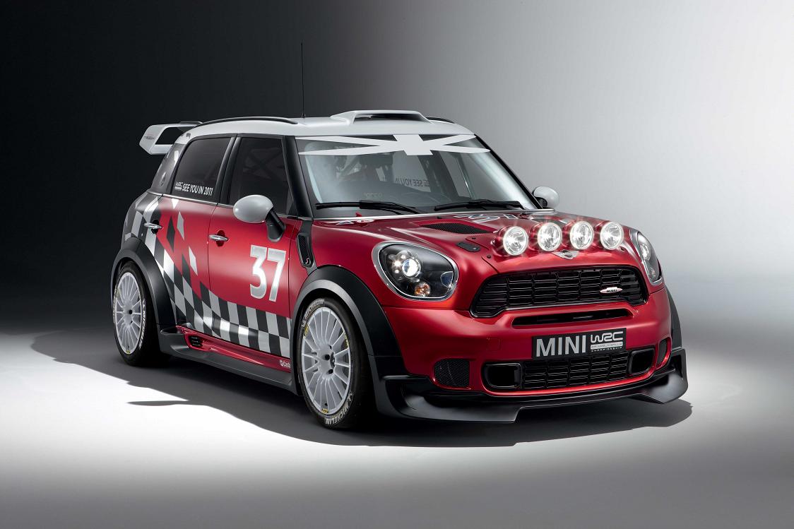

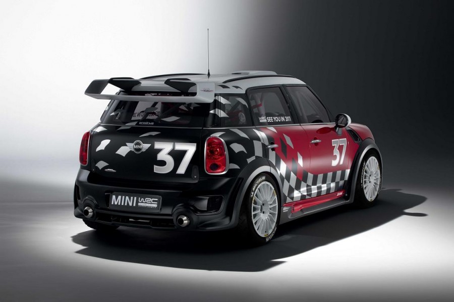

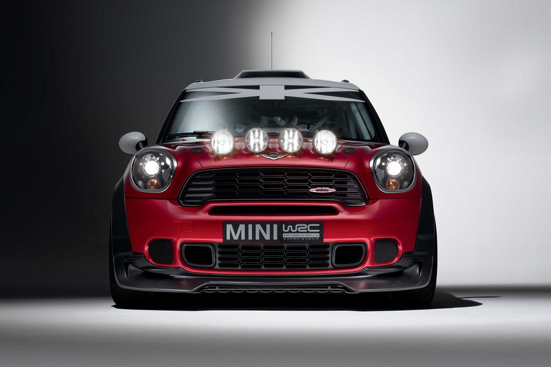

Technical specifications MINI WRC
Get to know the challenger for the FIA World Rally Championship in detail.
Dimensions:
Length: 4,110 mm
Width: 1,820 mm
Weight: 1,200 kg (FIA minimum weight)
Engine:
BMW Motorsport 1,600 cc, direct injection petrol
Garrett turbocharger - maximum boost 2.5 bar
Dry sump
Transmission:
Permanent four wheel drive
Gearbox: Xtrac 6-speed sequential
Clutch: AP Racing sintered twin plate
Front differential: Plated limited slip
Rear differential: Plated limited slip
Steering:
Hydraulic power assisted
Chassis:
MINI Countryman bodyshell with Prodrive roll cage exceeding FIA regulations
Suspension:
Front: Prodrive Öhlins Macpherson strut, 3 way adjustable damper
Rear: Prodrive Öhlins Macpherson strut, 3 way adjustable damper
Wheels:
ATS wheels and Michelin tyres
Gravel: 15” diameter
Tarmac: 18” diameter
Brakes:
AP Racing
Gravel: Front: four piston, 300 mm / Rear: four piston, 300 mm
Tarmac: Front: four piston, 355 mm / Rear: four piston, 355 mm
