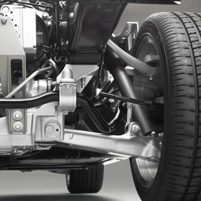

Both production Corvettes and C6-Rs share hydroformed chassis rails and the tooling used to make them. The perimeter rails go from bumper to bumper and resemble a ladder laid down, much like a truck frame in a single plane. A tunnel down the car centerline boosts torsional stiffness. Shear walls built off the tunnel react loads to the rails.
Despite a weight penalty, race cars use steel rails as opposed to aluminum for production Z06s. The use of steel simplifies joining of the 4130-steel roll cage to the rails. It is important to weld the triangulated-truss roll cage "into" the frame rails because the chassis derives much of its stiffness from the arrangement. Aluminum-to-steel joining methods simply don't give the same level of integrity as welded sections.
Further stiffening comes from the floor panels. Production Z06s have separate, balsa-wood-core composite floor panels and a bolt-in panel tunnel. Composites get their strength from the shear modulus of the core, because the outer sheets try to slide relative to one another under load. It turns out that balsa's shear-modulus-to-weight ratio is better than that of synthetic materials. But balsa also burns easily, making it inappropriate for a race car. The C6-Rs instead use a fire-resistant Nomex core with carbon-fiber sheet. Nomex is a known quantity in racing and well understood. It's also simple to form Nomex into complex shapes. A single 0.75-in.-thick panel goes from the firewall to the frame rails, and to the rear bulkhead. The combination of steel rails, roll cage, and one-piece floor give the C6-R a torsional stiffness of 28,000 lb-ft/deg, compared to about 9,000 to 10,000 lb-ft/deg for a production Z06.
The engine cradle is another key chassis component and one in which production cars are " highertech" than the race cars. Z06s use lightweight, castmagnesium engine cradles, while the C6-Rs opt for steel. The earlier C5-Rs incorporated production cast-aluminum engine cradles. But the castings had provisions for ABS modules, A/C, and other systems that the race cars didn't use and had to be machined off to save weight. Engineers found it easier and cheaper to build custom engine cradles from steel tubing.

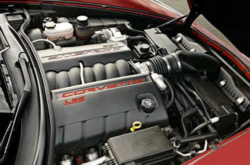

LS7 engine
The all-new LS7 of the ’06 Z06 reintroduces the 427-cubic-inch engine to the Corvette lineup. Unlike the previous 427 engine, which was a big-block design, the new 7.0-liter LS7 is a small-block V-8 - the largest-displacement small-block ever produced by GM and a tribute to its 50 years as a performance icon.
With 500 horsepower and 475 lb.-ft. of torque, it also is the most powerful passenger car engine ever produced by Chevrolet and GM. The LS7 is easily identified under the hood by red engine covers with black lettering.
The LS7 shares the same basic Gen IV V-8 architecture as the Corvette’s 6.0-liter LS2, but the LS7 uses a different cylinder block casting with pressed-in steel cylinder liners to accommodate the engine’s wide, 104.8-mm-wide cylinder bores; the LS2 has 101.6-mm bores. And when compared to the LS2, the LS7 also has a different front cover, oil pan, exhaust manifolds and cylinder heads.
Internally, the LS7’s reciprocating components make use of racing-derived lightweight technology, including titanium connecting rods and intake valves, to help boost horsepower and rpm capability. The rpm fuel shut-off limit is 7000 rpm.
The LS7’s specifications include:
* Unique cylinder block casting with large, 104.8-mm bores and pressed-in cylinder liners
* Forged steel main bearing caps
* Forged steel crankshaft
* Titanium connecting rods with 101.6-mm stroke
* Cast aluminum flat-top pistons
* 11.0:1 compression
* Dry-sump oiling system
* Camshaft with .591-inch lift
* Racing-derived CNC-ported aluminum cylinder heads with titanium intake valves and sodium-filled exhaust valves
* Titanium pushrods and valve springs
* Low-restriction air intake system
* Hydroformed exhaust headers with unique “quad flow” collector flanges.
“In many ways, the LS7 is a racing engine in a street car,” said Dave Muscaro, assistant chief engineer of small-block V-8 for passenger cars. “We’ve taken much of what we’ve learned over the years from the 7.0-liter C5-R racing program and instilled it here. There really has been nothing else like it offered in a GM production vehicle.”
One of the clearest examples of the LS7’s race-bred technology is its use of titanium connecting rods. They weigh just 480 grams apiece, almost 30 percent less than the rods in the LS2 V-8. Besides being lightweight, which enhances high-rpm performance and rpm range, titanium makes the rods extremely durable.
The LS7’s CNC-ported aluminum cylinder heads are all-new and designed to meet the high airflow demands of the engine’s 7.0-liter displacement, as it ingests approximately 100 cubic feet more air per minute than the Corvette’s 6.0-liter LS2 V-8 - an 18-percent increase in airflow. Consequently, a hydraulic roller camshaft with .591/.591-inch valve lift is used to allow plenty of air to circulate in and out of the engine.
To ensure optimal, uninterrupted airflow, the LS7’s heads have straight, tunnel-like intake runners. Very large by production-vehicle standards - even racing standards - they are designed to maintain fast airflow velocity, providing excellent torque at low rpm and exhilarating horsepower at high rpm. The heads feature 70-cc combustion chambers which are fed by huge, 56-mm-diameter titanium intake valves. The lightweight titanium valves weigh 21 grams less than the stainless steel valves used in the LS2, despite the valve head having 22 percent more area. They are complemented by 41-mm sodium-filled exhaust valves, vs. 39.4-mm valves in the LS2. To accommodate the large valve face diameters, the heads’ valve seats are siamesed; and, taken from experience with the engines of C5-R racecars, the LS7’s valve angles are held at 12 degrees - versus 15 degrees for the LS2 - to enhance airflow through the ports.
All LS7 engines are assembled by hand at GM Powertrain’s new Performance Build Center in Wixom , Mich. The exacting standards to which they are built include deck-plate honing of the cylinders - a procedure normally associated with the building of racing engines and almost unheard of in a production-vehicle engine.
