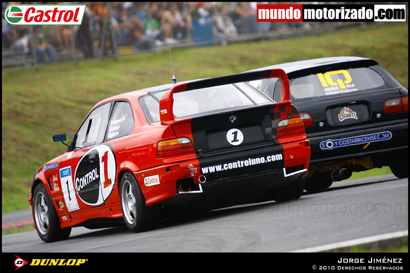

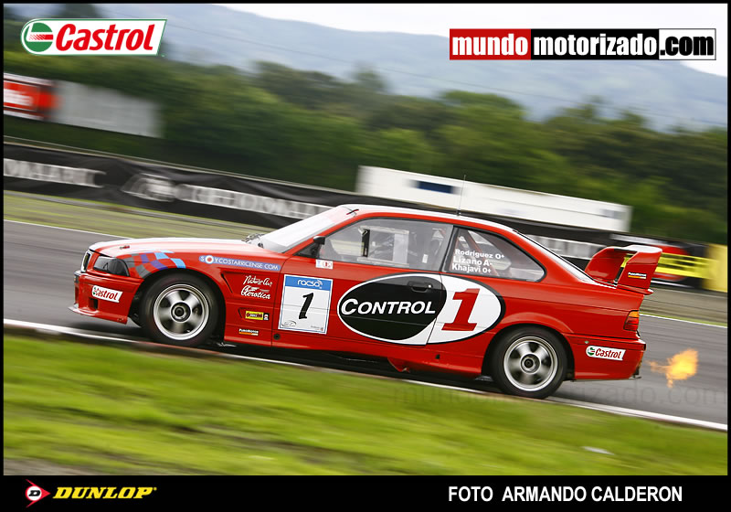

Flame throwing and pretty...before the multiple contacts with #5.

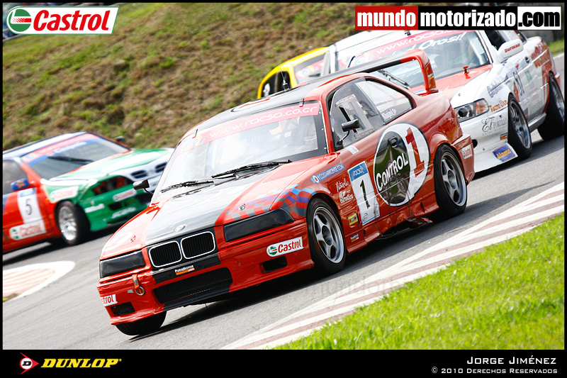

The damage effected the ability for the door to stay closed, broke the undertray mounts and shattered the front fender and rear bumper. The rocker panel was badly dented in and the rear wheel was toeing out from the hit. I went to work but could do little with the short time and lack of help, though my 7 year old did carry over a 20 kilo tool box for me!! So more tape, some hammering and out we go for the final race!
Still pushing hard with lots of signs of the multiple contacts with #5!
