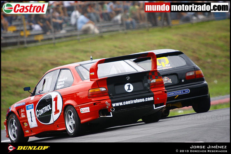

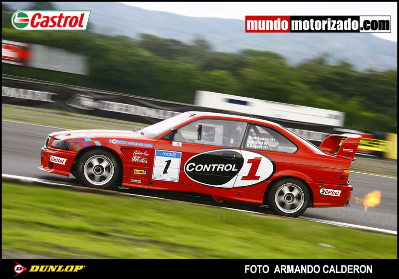

This car will leave Costa Rica in two weeks unless it is sold. $20K USD get the car and the extensive spares package!
Description
This car was built from the ground up to compete in a Professional Touring car series in Latin America. The series is an FIA event with all such requirements. The car is light, nimble and powerful. It is a complete package including spare engines, transmissions, differentials etc... This is a Turn Key operation for the new owner! Only the best components were used throughout. Driver adjustable brake bias with tilton brake cylinders for front/rear/clutch. Interior defrosting system for the windshield, driver ice cooling system, full radio system, wipers, fuel sample ports and pump overide switch, wired for headlights for night racing, wideband O2, Full AIM data aquisition system with track mapping and data logging. Electric fan with driver controlled tip in temperature switch or overide, transponder hard wired, bumpers Dzus tabbed for quick removal, brakes have professional ducting to rotor center, much more!!
History
Car was built in 2009 to compete in the new Super Tourismo Pro Touring car series in Latin America. The rules are very similar to World Challenge with the SCCA. The car was imported from the USA mid year 2009 after being converted from a street car by Piper Motorsports who installed chassis bracing, 6 point safety cage and did the full strip of the car. The car then went through a full build up of the suspension, brakes, interior, body, and engine. The car is very light for an E36 chassis car at only 2200 pounds! The chassis is solid and well engineered. The car is strait with no major crash damage or shunts. In the eight events entered in 2009/10 the car finished every single race (sometimes four races in a weekend, and endurance races as well) with 100% reliability! This car is solid as a tank! The new engine has 4 races on it and has a even 0.25% leakdown on all cylinders! The engine was professionally built by a veteran racing engine builder and was blueprinted to within 1/4 gram! The engine is good for 2 seasons of racing without a freshen-up! Always the best looking car on the grid, it is a car your can be proud to compete in!
Recent Competition History
Finished Top 5 in last racing weekend.
Performance Data
* Class: Super Tourismo, FIA
* Weight: 2200 lbs
* Best Time: 70 sec
* Track: La Guacima Costa Rica
Engine
* Engine Builder: Khajavi Motorsports
* Manufacturer: BMW
* Type: Touring Car, Super Tourismo, SCCA World Challange, SP
* Displacement: 2500cc
* Horsepower: 250
* Torque: 240
* Induction: BMW OEM
* Heads: BMW OEM
* Block: Aluminum Euro BMW OEM
* Main Caps: BMW OEM
* Crankshaft: BMW OEM
* Connecting Rods: BMW OEM
* Pistons: BMW OEM
* Camshaft: BMW OEM
* Valves: BMW OEM
* Valve Train: BMW OEM
* Clutch: Custom 4 puck lightweight Racing Disc
* Pressure Plate: Modiifed E30 M3
* Flywheel: Significantly lightened BMW OEM
* Exhaust: BMW OEM, 3
* Total Time: 12 hrs
* Races: 8
* Engine has 4 races on it since overhaul
Fuel System
* Fuel Cell
* Manufacturer: Custom Modified BMW
* Age: 2 months
* Capacity: 7 Gals
* Fuel Pump: BMW OEM
* Fuel Type: Pump 91/92
Oil/Water System
* Radiator: BMW OEM
* Water Rad Location: OEM
* Water Pump: BMW Motorsports lightweight impeller
* Oil Cooler: N/A
* Oil Cooler Location: N/A
Electrical System
* Ignition: BMW OEM
* Alternator: BMW OEM
* Battery: Brail 7 pounds
* Data Logger: AIM Sports GOLD with Dash
* Computer: BMW OEM
Transmission
* Manfacturer: BMW OEM ZF
* Type: M3
* Gears: 5
* Shifter: BMW OEM Modifed
* Trans Cooler: N/A
* Races: 2 races
* The car has an additional core Getrag Transmission
Rear End
* Manufacturer: BMW OEM
* Type: OEM
* Cooler: N/A
* Ratio: 3.23, 3.92, 4.10
* Case: OEM
* Differential: BMW Modified LSD
* Axles: BMW OEM
* Races: 2 races
* The car has three differentials
Body
* Construction: CF Hood skin, FG Front Fenders (vented), FG/K Cust front spoiler, M3 bumpers, CF Rear Wing, FG Truck
* Color: Hellrot Red
* Paint: PPG
* Condition: Perfect
* Car has moulds for the sunroof, rear trunk, front spoiler. Spare bumpers etc....
Chassis
* Type: BMW Motorsports X brace, Piper chassis kit
* Builder: BMW
* Material: OEM
* Finish: stripped
* Condition: Excellent
* Front Suspension: Custom struts with KONI 2X adjustable inserts, coil-overs with Eibach springs, Delrin mounts
* Rear Suspension: Koni 2X adjustable dampers, Ground Control jackers, Aluminum arms, Eibacj Springs, Delrin Mounts
* Shocks: KONI Racing Inserts (8 races), KONI Pro 2X rear dampers (2 races)
* Brakes: BMW M3 F&R X-drill rotors, Porsche/Brembo 4 piston calipers
* Steering: BMW Modified Manual rack
* Wheels: Rota Racing lightweight wheels (12)
* Tires: Hankook Ventus (12 scrubbed, 2 stickers)
Interior
* Color/Finish: Red, Stripped, placarded switches
* Material: SPARCO Full Containment Touring Car seat on sliders
* Fire System: Halon 10 pound with two nozzels, driver activated
* Restraints: Schroth 6 point, cam release (new 2009)
* Guages: AIM Sports digital dash, PLX digital guage
* Steering Wheel: MOMO Racing, quick release
* Condition: Like new
Spares
* Spare Aluminum Block engine (not legal for ST, but OK for SCCA and others) +HP!
* Getrag 5spd Transmission Core
* Three compete differentials, one with LSD, several R&P ratios to choose from.
* Spare Delrin Engine Mounts
* Spare Delrin Transmission Mounts
* Spare Suspension arms
* Spare Brake calipers
* Spare brake pad sets (several)....lots more....
